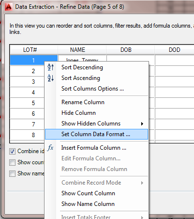

I'm doing a data extraction with a block with attributes. When I extract the data, it sort like the image below. I want it to sort 1,2,3,4,5,etc...
Any ideas on how to fix this problem.

I found the solution...Thanks for the help.
Change the column data format to "Whole Number".
Strange. I tried that on my test drawing and it didn't work that's why I did not mention it. Must have done something wrong. Glad you found a solution and thanks for sharing the knowledge.
Oops, it just dawned on me why it did not work. I tried that option AFTER exporting the data to a table. Duh! Thanks again.
