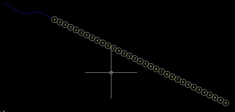

Hi Tiger,
Looking back at my code, I realised that I could tidy it up a bit, and so I have posted a much more user friendly version of the program.
The LISP functions much like before, but you don't have to specify a dwg-scale, and also, you don't have to specify the number of tags - meaning that you can just keep adding tags until you don't specify some tag text.
See what you think, and let me know if this helps at all:

Attached is an example of how it can be used, if you want to go crazy :P
