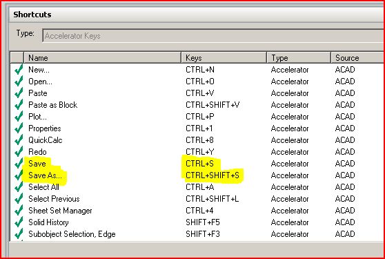

GISdude Posted November 22, 2013 Share Posted November 22, 2013 Hi all, Some how the variable for saving the dwg file has changed. So, when I save a dwg, I get the prompt for me to type in the file name. Anyone know by chance what the setting is to change it back? Many thanks Quote Link to comment Share on other sites More sharing options...
Dadgad Posted November 22, 2013 Share Posted November 22, 2013 Where are you accessing the command? I doubt very much that it is a system variable issue. I would also be curious how a command macro might have changed, without someone having gone into the CUI and manually doing it. You can use the ACCELERATOR KEYS to do this, or give us a bit more information, and we will get you sorted out. Quote Link to comment Share on other sites More sharing options...
Dana W Posted November 22, 2013 Share Posted November 22, 2013 Hi all,Some how the variable for saving the dwg file has changed. So, when I save a dwg, I get the prompt for me to type in the file name. Anyone know by chance what the setting is to change it back? Many thanks Here's the "Check the gas guage" answer. Verify that the system variable filedia is set to . If it is , then change it to . Do you by chance have a script active? If so, the file dialog window may not show while it is, even if filedia = . Quote Link to comment Share on other sites More sharing options...
Dadgad Posted November 22, 2013 Share Posted November 22, 2013 Here's the "Check the gas guage" answer. Verify that the system variable filedia is set to . If it is , then change it to . Do you by chance have a script active? If so, the file dialog window may not show while it is, even if filedia = . Good thinking Dana, 'guage'?, isn't that how the French spell it? Quote Link to comment Share on other sites More sharing options...
GISdude Posted November 22, 2013 Author Share Posted November 22, 2013 filedia was the answer. I don't understand how it could have changed, other than the sys admins are doing something to the profiles. Thanks for the reply's. Quote Link to comment Share on other sites More sharing options...
