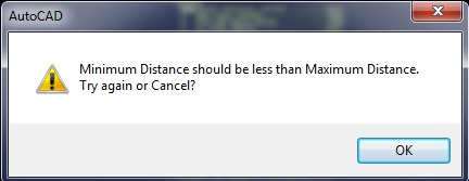

I just started getting this. running new machine with autocad 2013 and cadworx piping suite 2013. not sure why I'm getting this, seems to be company wide.
any help would be great.
this pops up every time I flip windows/drawings, open or close...

So i figured this one out, it was a tolerance setting for Clash/ dicontinuity in Cadworx Plant. they were both set to 1.
