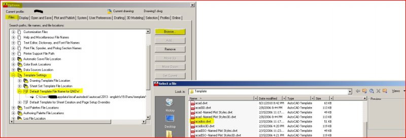

If you typically work in Metric then you should set your DEFAULT QNEW TEMPLATE
to a metric one.
Right click in your commandline to access and select OPTIONS.
Click on the FILES tab, then reference the attached screenshots.

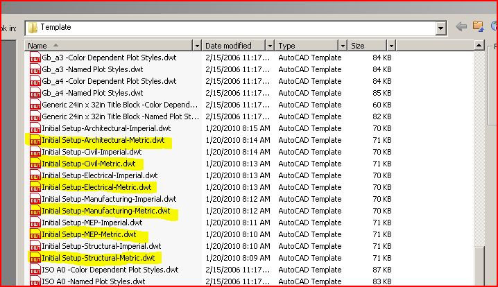

In addition to the templates ending in ISO, there are other discipline specific
metric based templates available.
By selecting one of these metric templates you will ensure that
when you start a new drawing, by using QNEW, it will be started
on the template of your personal choice.

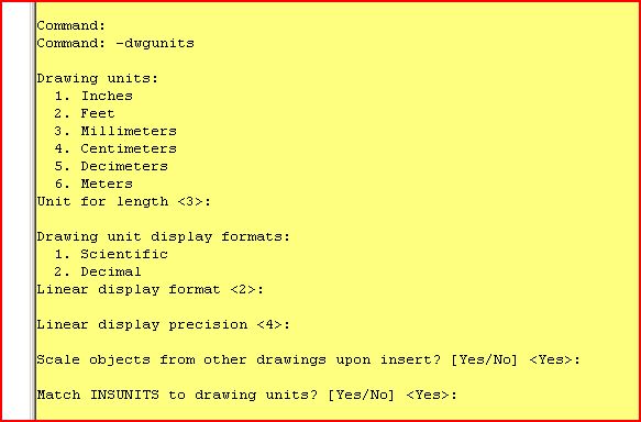

In order to confirm that you are drawing in whatever units you choose,
you can use the -DWGUNITS command (include the hyphen),
looking at the commandline history image, you will see that centimeters
is 4, I always use 3, as I draw in mms.
