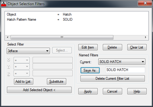

tzframpton Posted December 3, 2013 Posted December 3, 2013 Is Selection Cycling available in 2009? Also, you can always use the Filter tool and save the selection set for future use. Quote
