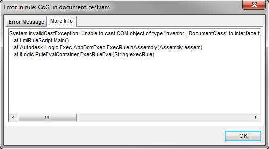

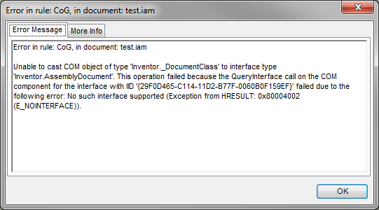

Aaaaannnnnddddd then it didn't. With assembly open, then generated idw for assembly. When go to close drawing and save changes you get pop-up to include assembly in save. If you say yes you get following error message (second pic is the "more info" tab, of which the first line runs off to the side but is everything in pic 1):
Functionally nothing appears to be wrong. All geometry updates correctly as does cg workpoint, it appears to just be a communication error. If you select "no" for the assembly when saving the drawing file, the drawing will save and close properly with no error code. Then when you close the assembly you save changes and it saves and closes fine with no error code.
Anyone have any clue what might need to be tweaked?
