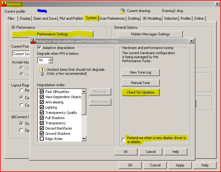

Dadgad Posted December 9, 2013 Posted December 9, 2013 You might want to check this link out. http://withoutanet.typepad.com/without_a_net/2010/04/update-2-released-for-autocad-and-autocad-lt-2010.html Confirming that you have the latest drivers is a good idea too, very simple, as shown in the image. Quote
Detailkim Posted December 9, 2013 Author Posted December 9, 2013 The sneaky baskets, that simple!! I've downloaded and installed that, and I'll try that and see how I go today. My systems tab in options doesn't give me a performance button like your illustration but I get the drift. Thank you for your support and input. Cheers Quote
Dadgad Posted December 9, 2013 Posted December 9, 2013 Oh right, sorry I forgot you are using LT, no 3D. Hopefully the service pack might help you a bit, it is always a good idea to keep up with them. Quote
