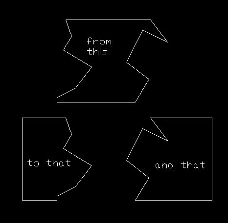

Still not entirely clear in my mind, but take a look at image below which is a simplified representation of what I think you are after.
ymg
