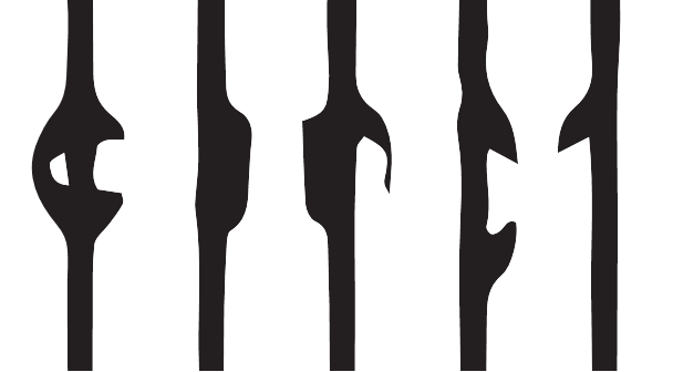

You are very welcome MVMV.
If you'll stay around here long enough, you will meet the true magicians...
Back to your work, how do you manage these situations?
And another question: Do you need the horizontal lines in dwg?
I wish to discuss more about this but I have to go now.
I know this isn't the answer on your question, but I couldn't resist to experiment a little...

Stefan,
I think i need to find a way to make a more smooth halftone pattern. Need to figure that out. But I'm afraid i will have to clean the halftone manual. Also i need to split every spline so they dont touch each other
Marco,
I'll try your LISP later. Can you tell me what it does exactly? We have some sheet piling issues in the project, so other priorities now.
Here is Stefan's code with my mods that is applicable for cases posted in post #22... Although not tested, it should work I think slower, but correct... I've removed horizontal lines as your request... Test it and report if somethings wrong...

This is what is my previous post for - it's extension of (vlax-curve-getclosestpointtoprojection) function... Study this code and you'll figure out its purpose...
Edited by marko_ribar
code changed
I've changed both my codes and did tests - on spline entities code may error, but if you pedit splines into polylines it may do the job...
Test it and tell me your results...

Stefan,
I hope you will find an easier way for that part of your work.
About my lisp, just use it a while and if you think it need adjustments, improvements, don't be shy, come here and let me know.
BTW: i dont need the horizontal lines in DWG
All you have to do is to add 2 semicolons.
Edit the lisp file, add semicolons, save file AND reload it in Autocad.

After changing my subfunction for a few times, I discovered that I had mistake in (vl-sort) function... Now that's correct - look in my attachment - it worked on this example, but as my sub-function is highly unstable, I do suggest to avoid it and maybe try with intersectwith method and XLINE that is to be erased...
M.R.
profile-test.dwg
New update of my last code... But it's only applicable for cases of open LWPOLYLINES that lie in WCS and that are aligned with equal Y coordinates of start/end vertices like posted request... Now routine works much faster and is predicted to work and with cases posted in post #22...
HTH, M.R.
I've noticed also that sometimes, when supplied point, entity and normal vector to (vlax-curve-getclosestpointtoprojection) it may return not first point on smallest parameter on curve, but sometimes just opposite on largest parameter, so I've updated my first code that is referenced to SPLINE, PLINE entities as long as start/end vertex isn't one of resulting vertex in a list of points... Note that my (vlax-curve-getclosestpointtoprojection-a) posted above isn't applicable to CIRCLES, full ELLIPSES, XLINES, RAYS and is also very unreliable if used in some other function - use it with very carefully...
But I think, for your case and situations from post #22, the best is XLINE with intersectwith method...
