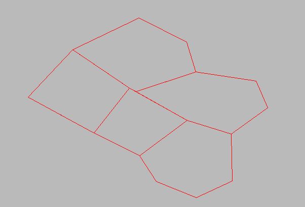

I have many many closed-plines
Step1 :Automatic Create point centroid closed polylines
Step2 :Automatic Create numbering and area
Step3: Automatic Split one by one parcel and publish it. (Contemporaneous )
Help me to write autolisp!

As I understand the requirements, the OP needs an output exactly like Bpoly. Each area has its own closed polyline. From the posted example drawing, to do it by creating individual polylines, you would have to first of all have to duplicate the common boundary lines, then even split some lines, and then join the relevant lines to make a closed polyline. Almost exactly the effect of Bpoly. :o
These polylines would then be consecutively numbered and, with their area, be extracted in tabular form either internally or externally.
I think that the OP wants some automagical autolisp to save clicking in each area. You might wonder what draughtsmen are paid for nowadays.
If the OP were to set up a new layer before using the Bpoly command, then all the closed polylines would be on this new layer. You only need to start Bpoly once, then carry on clicking. You would reach a million in no time at all.

Can we pick point up left --->pick point down right to select all lines or polyline .Only step and result : to Closed - Polylines!
You can do that. PEDIT > Select all lines (point up left then point down right) > Join.
That will give you Polylines. Then again, pick point up left > Pick point down right to select all polylines > Properties > Change Closed to Yes.
That will give you nothing but closed polylines - BUT AutoCAD is not so smart, it doesn't know where you want a polyline and where you don't. For that you need BPOLY, and BPOLY works when you click inside the area that you want a close Polyline of.
You can't ask AutoCAD to know what areas are the important ones, and what areas are not important. That is (probably) what you are paid to do.
