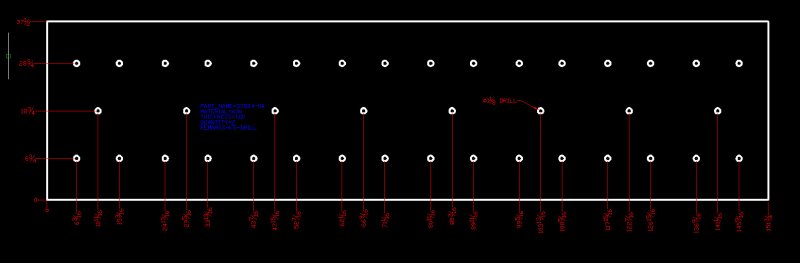

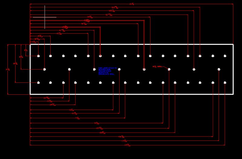

dblclkmatt Posted December 13, 2013 Posted December 13, 2013 I will receive printed out drawings that are entirely drawn with the use of ordinates, putting the 0,0 point in the corner of the part, and dim everything from that corner. Like this example: The problem I'm having is when I recreate the parts digitally and have multiple parts to dimension, I can do one that looks as clean as the ordinate version, but the rest are dimensioned using the baseline tool, and look like this: Though it works, it takes a while to make it nice and legible for my print out version. And most the time the parts are more organic and don't have any corners, but this is the best example for my question. I know I can't have multiple 0,0 points in model space, but I was hoping there would be a better way to achieve the clean look of the ordinate points. Or perhaps create a reference point that can be duplicated, moved, and the ordinates will recognize. Note: As much as I'd like to use paper space to dimension my parts, I can't. Quote

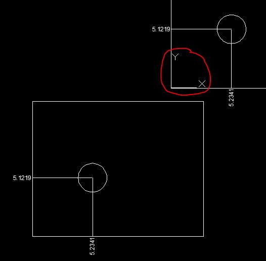

rkent Posted December 13, 2013 Posted December 13, 2013 You can create as many UCS as you want which establishes the 0,0 origin for you, wherever you want it. UCS, Origin, pick a point. Dimension away. Repeat for the next part. Quote
ReMark Posted December 13, 2013 Posted December 13, 2013 Why can't you specify a new origin by relocating your UCS to the lower left hand corner of the next part to be dimensioned? rkent beat me to it. Quote
ReMark Posted December 13, 2013 Posted December 13, 2013 No, I didn't just copy the rectangle and circle. I moved my origin. Note the location of the UCSicon. Also note that despite being dimensioned separately both circles have the same ordinate dimensions. Quote
dblclkmatt Posted December 13, 2013 Author Posted December 13, 2013 [ATTACH=CONFIG]45674[/ATTACH]No, I didn't just copy the rectangle and circle. I moved my origin. Note the location of the UCSicon. Also note that despite being dimensioned separately both circles have the same ordinate dimensions. I... I had no idea that I could move that thing. I thought it was hard coded to its position. I guess I've been asking the wrong question in my search for this solution, because that had never come up as a possibility. Thanks for making that such a simple fix; ReMark, rkent. Quote

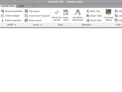

nestly Posted January 7, 2014 Posted January 7, 2014 Just an FYI. Autocad has an internal Command alias editor available via Express Panel or Express menu or ALIASEDIT from the command line. IMO, this is the easiest method of editing the pgp as the user doesn't need to worry about syntax, or whether they're editing the correct pgp, or remembering to REINITialize AutoCAD after making changes. Quote
ReMark Posted January 7, 2014 Posted January 7, 2014 Re: Re-initialization. After issuing the REINIT command check off the box for PGP File then click the OK button. Quote
