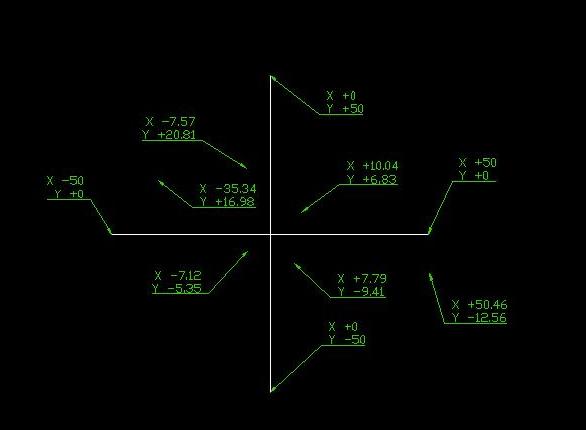

I have two similar procedures,There are differences with the picture,Someone help me changed it!thank you!
Lead endpoint with arrows
X,Y Values must have Plus or minus

Someone help me change it? thanks very much!
flyfox1047,
For bz.lsp just add the following to get your plus sign (if (minusp (car p1)) "" "+" )
ymg
Revised code below:

Here's the second one modified for the plus sign.
Now, for the life of me, why would you use such antiquated routine.
This one is actually drawing a line and an a cross to somewhat imitated
a leader.
This is what you should be using "LEADER" for that task.

flyfox1047,
Something as simple as below actually does about the same as what you want,
while keeping the advantage of style definition.
ymg

Hi ymg,thank you! I don't know why text garbled,Can't work normally
(defun c:lb (/ p x y str)
 (while (setq p (getpoint "\nPick Point: "))
    (setq   x (strcat "X = " (if (minusp (car p)) ""  "+" ) (rtos (car   p))))
    (setq   y (strcat "Y = " (if (minusp (cadr p)) "" "+" ) (rtos (cadr  p))))
    (setq str (strcat x "\n" y))
   ;(setq   z (strcat "Z = "(if (minusp (caddr p)) "" "+" ) (rtos (caddr p))))
   ;(setq str (strcat x "\n" y "\n" z))
    (command "_LEADER" p pause "" str "")
This code is very good! concise,Thank you again !can you help me in this code create a dim layer, layer Color is green,put dimleader into the dim layer,dim precision Keep two decimal places

 (setvar 'clayer "dim")
 (while (setq p (getpoint "\nPick Point - ENTER to finish: "))
    (setq   x (strcat "X = " (if (minusp (car p)) ""  "+" ) (rtos (car p) 2 2)))
    (setq   y (strcat "Y = " (if (minusp (cadr p)) "" "+" ) (rtos (cadr p) 2 2)))
   ;(setq   z (strcat "Z = "(if (minusp (caddr p)) "" "+" ) (rtos (caddr p) 2 2)))
(defun c:lb ( / p x y str )
 (if (not (tblsearch "LAYER" "dim"))
   (entmake '((0 . "LAYER") (100 . "AcDbSymbolTableRecord") (100 . "AcDbLayerTableRecord") (2 . "dim") (70 . 0) (62 . 3) (6 . "Continuous")))
   (prompt "\nLayer : \"dim\" already exist - setting it to current and proceeding with routine...")
Very nice !marko_ribar, thank you!
