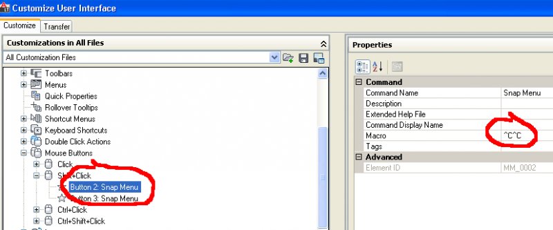

steven-g Posted December 16, 2013 Posted December 16, 2013 You can program the right mouse button (and wheel) to perform different commands in conjunction with the shift or ctrl buttons, open the CUI and look for mouse buttons, and change the macro to suit your needs (as standard most buttons will open the shortcut menu - so you can choose one to be the escape command) Quote
