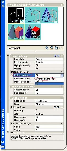

nocturne00 Posted December 1, 2008 Posted December 1, 2008 are you saying you want the materials displayed in conceptual or realsitic visual style? Quote
nocturne00 Posted December 2, 2008 Posted December 2, 2008 Is this what you are after? toggle visualstyles command Quote
