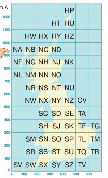

That is all very well, but for those not used to the Ordnance Survey, the first two letters of the tile have to be translated into numbers. The tiles are to an all number coordinate.
Something like this. Picture taken from the grid explanation for schools (which seems to be the only source with the numbers shown) Shows the 100 kilometre squares and coordinates.
Since the OP has disappeared without giving the technical detail for a desired lisp, I thought that I should provide a few figures.
The Ordnance Survey grid is a metric one. Normally coordinates have six significant figures in both the Easting and the Northings (with zeros filling up the leftmost spaces if necessary).
Working from the left hand side, the first digit of the Easting and the first digit of the Northing are combined to give a two character code. In the OP's case TQ, (which is near London). The next two digits of both the Easting and the Northing are then added to this to give a six character reference for the kilometre square.
So the OS tile labelled TQ3456, would in fact have the coordinate 534000mE, 156000mN for the bottom left hand corner of the tile.
I suspect that the OP is hoping for a lisp so that when clicking in the drawing, the coordinates would be read of the pick point, and with a simple bit of arithmetic, the correct tile would be inserted. As all the tiles are drawn to the proper coordinates, the insertion point for every case would be at 0,0.
Of course, Architects usually work in millimetres, so that an Architect factor of 1000 must be allowed for, if necessary. :D
