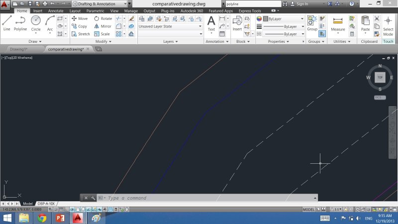

Pandabear2013 Posted December 19, 2013 Posted December 19, 2013 (edited) I am a first time Autocad user and have spent most of yesterday trying to work through this issue but am still not able to perform this. I have attached an image which on the lower part of the lines shows arcs with large radii which transition to parallel lines in the upper part of the image. Where the two meet there is an abrupt change in angle which I wish to have as a smooth transition from the gradual change in angle of the arcing lines to the parallel straight lines. If anyone can help out with this I would greatly appreciate it. This is how the transition between the line segments should look. Edited December 19, 2013 by Pandabear2013 Quote

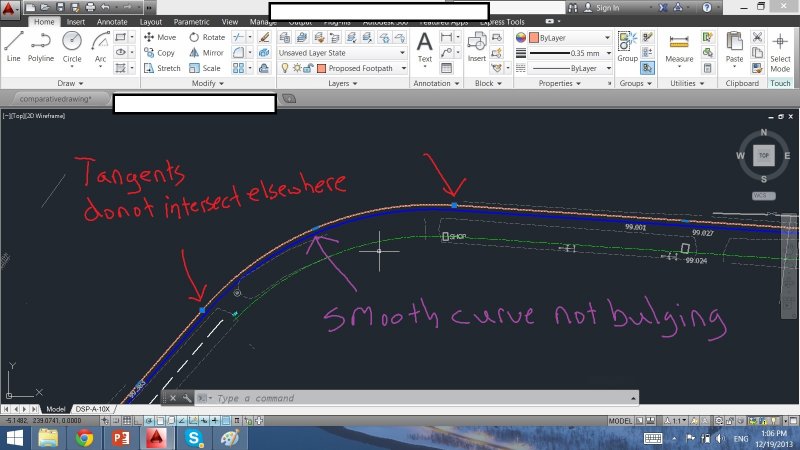

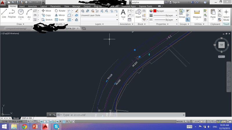

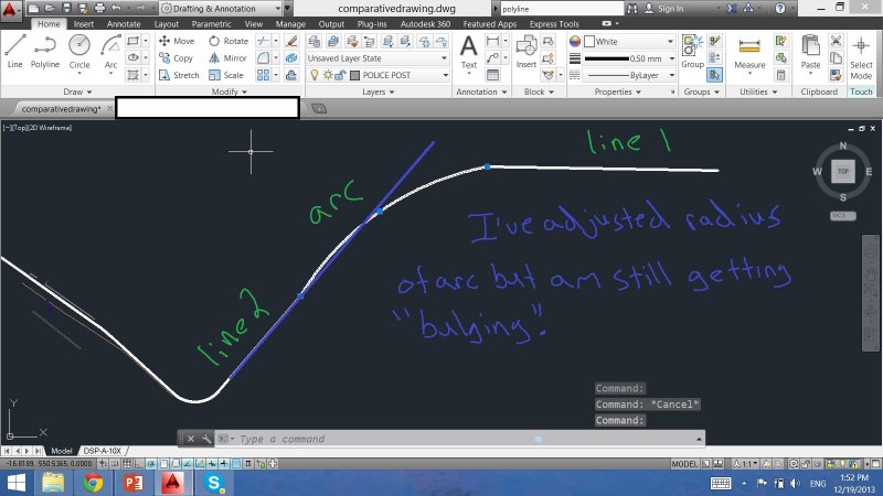

Pandabear2013 Posted December 19, 2013 Author Posted December 19, 2013 Thank you everyone for your input on this. I have attached a couple more images of the problem I'm trying to remedy. Hopefully this will make it more clear of what I'm trying to accomplish and the problems I'm having. In the example file the arc transitions smoothly into the straight segments of road, however when I attempt to recreate this I am getting a bulging arc and cannot figure out how to reproduce the line segments correctly. Quote

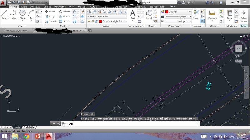

Pandabear2013 Posted December 19, 2013 Author Posted December 19, 2013 Did you get that effect using BLEND? Blend doesn't seem to be doing anything. I did get the fillet to work but I'm still not getting the desired effect. Maybe if someone could walk me through how to achieve the curvature in the example image with the two line segments at either end's position fixed that would be best. Adjusting the radius of the arc in between the two line segments doesn't seem to be the right approach. I just started using Autocad yesterday. Quote
eldon Posted December 19, 2013 Posted December 19, 2013 Perhaps you could check the Help on BLEND and see how it should work. You have to have two end points, which means shortening your line and curve, and it will blend in a join line. If your two lines actually meet, then it cannot do anything. Quote

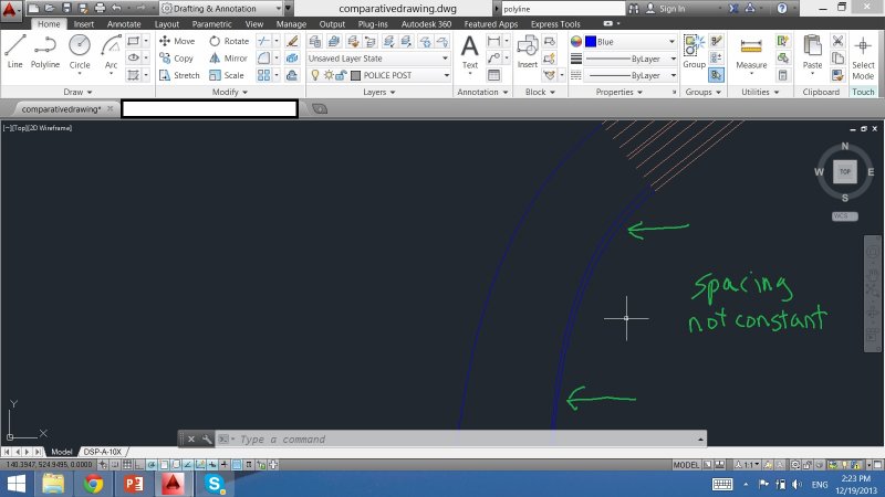

Pandabear2013 Posted December 19, 2013 Author Posted December 19, 2013 Finally, thank you very much for your patience and assistance. I do have a follow up question on this as well if you don't mind. I have a series of parallel lines that will be connected using the blend command. I would like the spacing between these lines to remain constant. Would you mind suggesting to me the best way to go about this? Quote
Pandabear2013 Posted December 19, 2013 Author Posted December 19, 2013 An image file is attached below. I think I've figured it out with offset. I guess Autocad is more intelligent than I expected. Thanks again for your help. Quote
eldon Posted December 19, 2013 Posted December 19, 2013 I would suggest that you use Blend on one pair of parallel lines, then use Offset. Then all lines will be parallel. Quote
