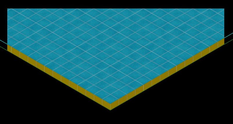

You can forget about my suggestion regarding the use of a 3D Face as you won't get consistently good results. However, there is something I'd like to show you here:
This is for demonstration purposes only so I used two different colored tile materials (ochre and cyan).
In this example the height of the base is 1" while the height of the top is 0.01" or just enough to apply a material to but not so much that it would negatively affect the overall height. Visual style: Realistic.
Would this be acceptable to do in your situation?

  • Face: Assign materials to individual faces of a 3D solid. Select a face using Subobject filtering by holding down the Ctrl key and selecting the face you want to apply a material to. Right-click the material you want to assign in the Materials Browser palette, and then choose Assign to Selection from the menu that appears.

That didn't go so well.
I tried to assign a material to a face of a cube. I filtered for "face" and pressed the Ctrl key prior to selecting. However AutoCAD didn't like something I did because I got this as a reply on my command line.
Cannot assign a material to a part of a historical solid. Only the solved solid or a face on the historical solid can have a material applied. For more information visit the Help.
I'm off to visit Help to see if he can "help" me.:unsure::lol:
OK...I'm back. I figured out what I was doing wrong which had to do with the way I was making my pick.:oops:
