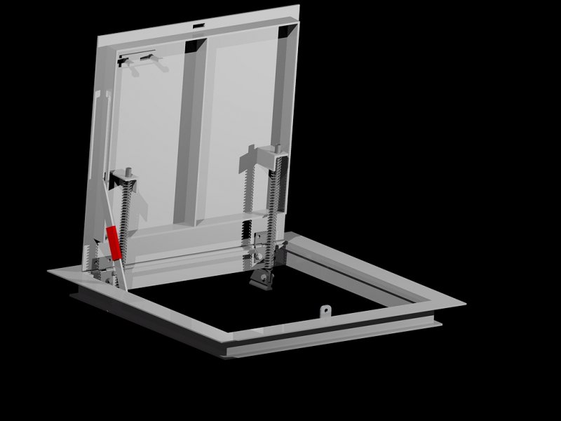

Bill Tillman Posted December 23, 2013 Author Posted December 23, 2013 Thanks. Here is what I've found works pretty good so far. Depending on the image I run the render with either a gray or black background. Then by setting the threshold in GIMP a little higher, I get the pixels I want and delete them so I end up with a pretty decent white background. Then I invert the selection and add a drop shadow. This is about as good as it's going to get. Now I need to figure out how to handle that saw-tooth affect that happens on the left door panel. And does anyone know where I can get a better material sample for the aluminum diamond plate. I'm using steel diamond plate and it just doesn't have that shiny, aluminum finish I'm looking for. Quote
Cad64 Posted December 23, 2013 Posted December 23, 2013 Thanks. Here is what I've found works pretty good so far. Depending on the image I run the render with either a gray or black background. Then by setting the threshold in GIMP a little higher, I get the pixels I want and delete them so I end up with a pretty decent white background. Then I invert the selection and add a drop shadow. This is about as good as it's going to get. Now I need to figure out how to handle that saw-tooth affect that happens on the left door panel. Are you saving your renders as jpg's? If so, don't. I don't know what formats Autocad can save to, but if you can, render and save as a high resolution tiff. That should give you a cleaner edge without such a bad stair stepping effect like you're getting now. Your render times will increase with the higher resolution though. Quote
