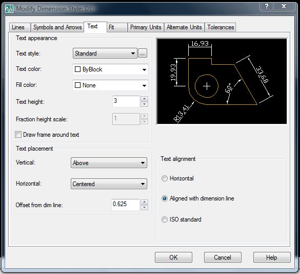

I am having problems centering dimensions. My dimension text settings are attached. Is there something I am missing? I want the dimensions centered. I have checked everything in the dimensions style and can't find what I missed.

try dim>upd>all
or select the troubled dimensions>right click>text position>home text.
should do the trick because you have it already centerd in your style.
how bout on dim properties>fit>fit options> always keep text between ext lines
Go to help menu and read something about DIMUPT.
