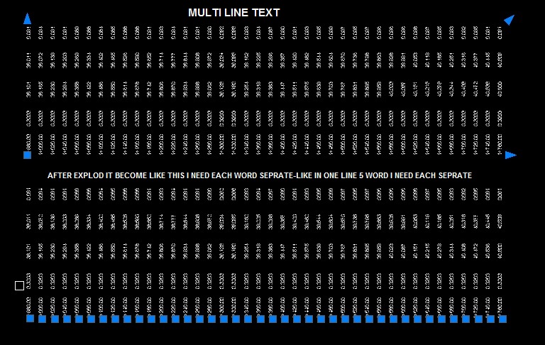

I have multi line text i want to break in one text
suppose i have 3 word in multi line text
i love you
so i want to break separate like i-love-you as well

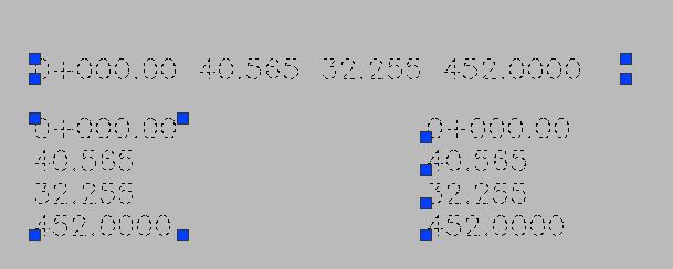

not break like this " suppose i have 0+000.00 40.565 32.255 452.0000"
these data in one line how can separate this all item like 0+000.00 one 40.565 as well
That is even easier than inserting breaks. Drag the top right-hand Grip towards the left, until the text is on single lines. Then Explode :D
neat solution 8)
