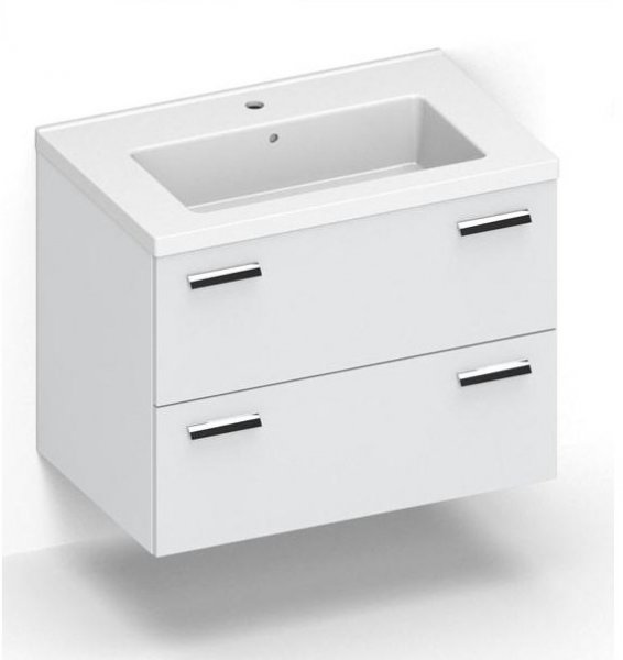

Hi. I am working on 3d model of interior and I have two problems. I am trying to made similar model as it is on the first image.
After setting all render properties and turning on sky and illuminations my view on object switch from isometric to perspective view.
Is there any way to change it to isometric view so the point of view do not change position at the time of changing, because I find out the way to return it to isometric but then the point of view that was placed inside of room is moved outside and I can't render object that was inside.

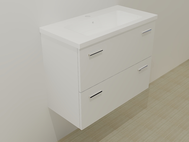

Also I can't set white background as it is on the first image. Second image is my attempt that is made inside of the room.

Hi. My mistake, I write a bed description of a thing I am trying to do and I posted wrong picture. Yes I am using web light and cameras.
I am not sure is this even possible in autocad but i will tell you in details what I try to achieve and what is going on in the drawing. I hope that you will understand what am I trying to say. :-)

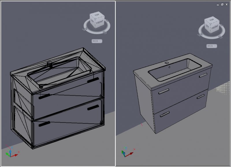

So it is like this. I put sink inside of a room with two windows. I place the camera inside of the room and point her to sink but I stay on current point of view. Set all render parameters and sky option which when I turn on change view to perspective view. I choose camera view position and I get in her position with view pointed to sink but it's in perspective view. And I want to do a render of a sink in isometric view.
Here is a picture with two types of view. Right one is when I choose camera view inside of a room. But I want the render which looks like left side of image. But I cant get that type of view inside of room. Instead of that I have to remove some walls and I cant get image i need.
And here is current image rendered from camera position.

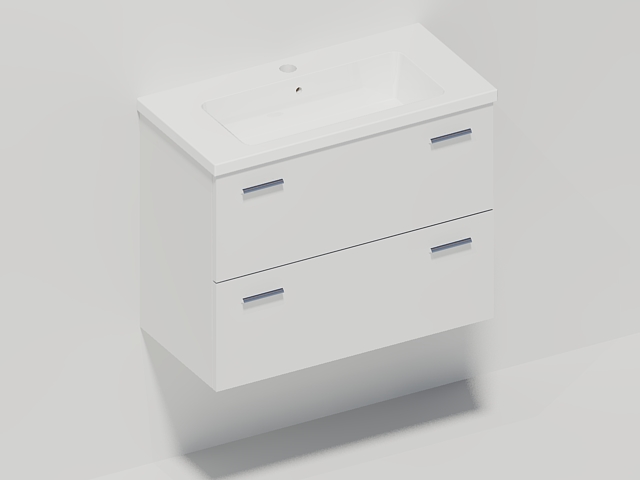

Here is a dwg in attachment. I had some problem with saving the original dwg so i made this one. Also here are two pictures. For both of them I used same rendering options on second one I added some floor material and it turn out diferent then the other one.

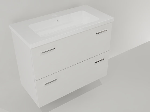

In meantime I tried couple of things and here is the result. I removed the some of the walls and leave only floor and back wall. So the sink is exposure to the sun light. And put it in isometric type of view.
Here are also some of properties that I used for this picture:
Advanced render option:
Presentation
Global illumination: ON
Photons/sample: 25
Radius: off
Final gather: on
Light properties/energy multiplier: 0.35
Sun properties/rendered shadow details:
Samples: 15
Softness: 6
But still I cant find the way so the back wall and floor can be little bit whiter and a way to do it as interior inside of the room.

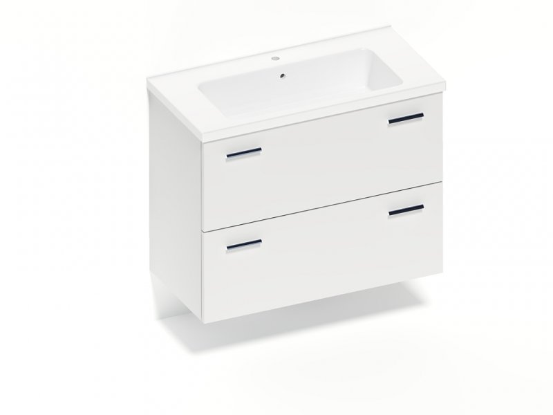

hi. thanks to all of You for your effort.
I tried couple of things and here is the almost satisfactory result
here are the parameters that i adjust for this kind of render
Advanced render settings:
Light properties - Energy multiplier: 2.3
Adjust render exposure
Brightness: 66
Contrast: 67
Mid tones: 1
Exterior daylight: on
Process background: on
Sun properties
Render shadow details:
Samples: 45
Sotness: 10
Because I made some changes in render exposure I needed to increase the value of Ambient and Difusse in Material editor
You did a very nice job. Thanks for sharing the image with us and for updating us on your progress.
