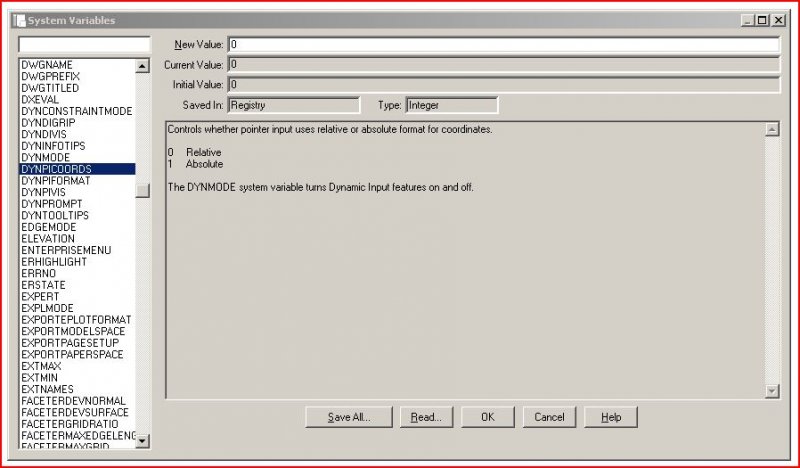

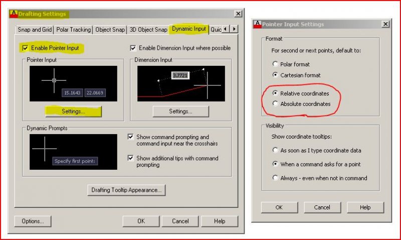

Dadgad Posted December 27, 2013 Posted December 27, 2013 Welcome to CADTutor Tyler. A footnote to nestly's post. Should you want to check your current dynamic pointer input settings, type DS (Drafting Settings) at the commandline and hit ENTER, then follow the visual prompts in the screenshot. This setting is controlled by the DYNPICOORDS system variable, as described in the second screenshot which was accessed by the SYSVDLG command. Another way to check the current setting is to type DYNPICOORDS at the commandline and hit ENTER. The current system variable setting will be displayed at the commandline, and you will be given the option of entering a new value, which for this particular system variable has to be either 0 or 1, as described in the screenshot. Quote

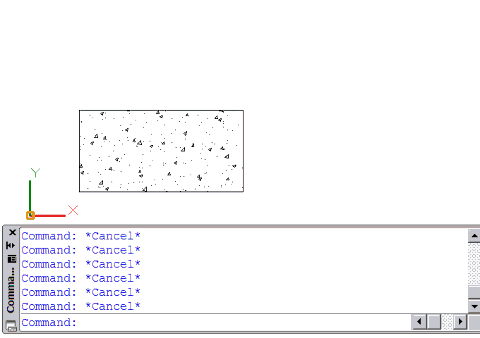

nestly Posted December 27, 2013 Posted December 27, 2013 AutoCAD typically does what it's told, so my guess is that the object is being moved to the coords you specify. To test, try drawing a line from 0,0 to 230,2370, then try moving the object again using #230,2370 as the destination. If you don't have the same result as shown below, press F2 and copy/paste the command line history from the beginning of the LINE command to the end of the MOVE command. If you can't share the drawing, and can't share the Command line history, then I'm not sure how we're going to be able to help you figure out what's going on. Quote
