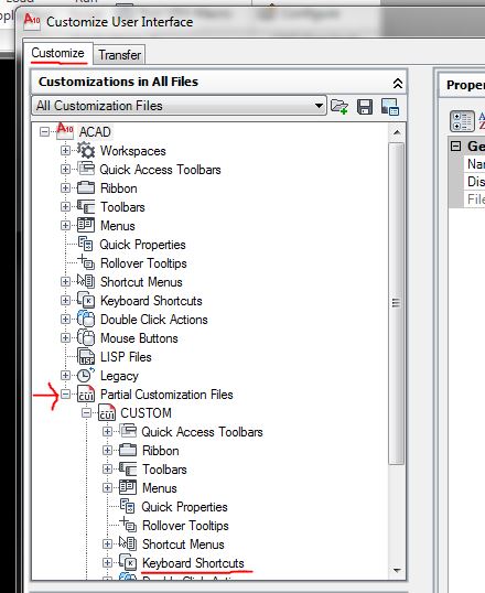

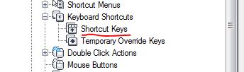

ReMark Posted January 3, 2014 Posted January 3, 2014 If I am not mistaken I think this is where you want to create your custom keyboard shortcuts. Quote
