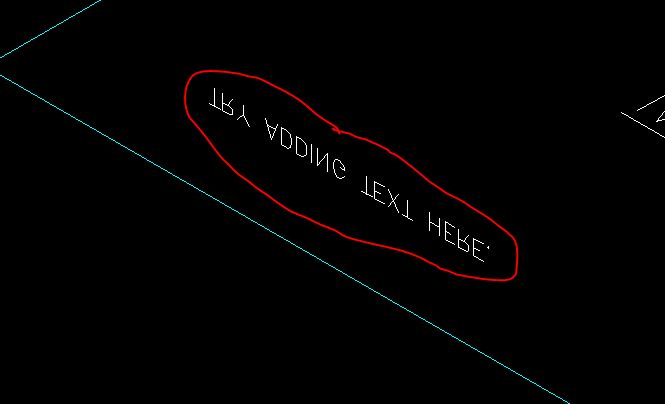

lkenshalo Posted January 3, 2014 Posted January 3, 2014 I have some text in vanilla Autocad 2014 that is showing up as dashed lines - any ideas on why that would happen? Quote
ReMark Posted January 3, 2014 Posted January 3, 2014 Is the text on a layer that has a dashed or hidden linetype assigned to it? Quote
lkenshalo Posted January 3, 2014 Author Posted January 3, 2014 ReMark - it's on a clean layer with a continuous line-type and the properties appear to be normal as far as I can tell. Quote
ReMark Posted January 3, 2014 Posted January 3, 2014 When you click on the text and check Properties do you see anything unusual? Is Linetype set to 'By Layer'? Quote
lkenshalo Posted January 3, 2014 Author Posted January 3, 2014 yep everything looks normal - if I change the thickness I get boxes rather than a dashed line Quote
ReMark Posted January 3, 2014 Posted January 3, 2014 Please bear with me as I conduct a short test. I'll be back. Test completed; failed. What font is this? Quote
lkenshalo Posted January 3, 2014 Author Posted January 3, 2014 here is a portion of the file - you can see the issue if you try and add text. edit for remark: this is a simplex font cadtutor.com.dwg Quote
ReMark Posted January 3, 2014 Posted January 3, 2014 I have just downloaded you file; please give me a moment to look at it. Good news: The text is there. Bad news: It is being displayed in an unusual way. Bear with me a moment; I'll be back. Quote
ReMark Posted January 3, 2014 Posted January 3, 2014 (edited) My test text which reads TRY ADDING TEXT HERE. I switched to a SE isometric view to see what was actually happening. Your text is being rotated into the drawing. BTW...you are looking at the lower left hand corner of your drawing. Edited January 3, 2014 by ReMark Quote
ReMark Posted January 3, 2014 Posted January 3, 2014 Try creating a new line of text using the DTEXT command and when prompted for the rotation angle of the text see if it says 180.00 instead of 0.00. If it does change it to 0.00 and continue. What is the result? Add another line or two of text but this time use MText. What happens? Quote
lkenshalo Posted January 3, 2014 Author Posted January 3, 2014 ReMark - I'm this close to flying to CT and buying you a beer. The original issue with the file was a UCS problem - someone drew it in some bizarre UCS configuration and I had to go back and reset it manually. originally the dashed line text was showing up vertically AS WELL as being dashed. changing the UCS around made the text horizontal but still dashed. It looks like you've just found out that the text is showing up dashed because we're viewing it on the leading edge. I'm going to try and figure out a solution to the problem but I may not have time immediately because I have a Civil3D class I'm preparing for in Monday. I'll post details when I get a chance to play around with the file - thanks again ReMark YOU ARE THA MAN! Quote
