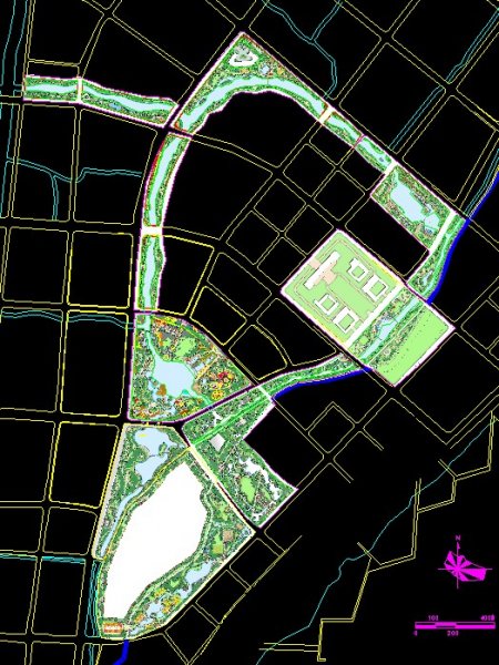

we were working on some planning stuff, altogether more than 100ha in area.

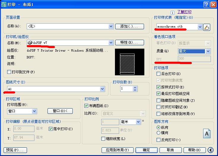

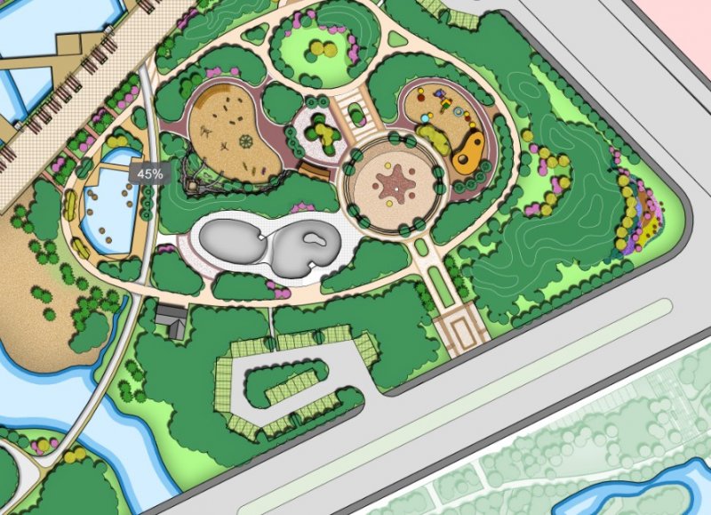

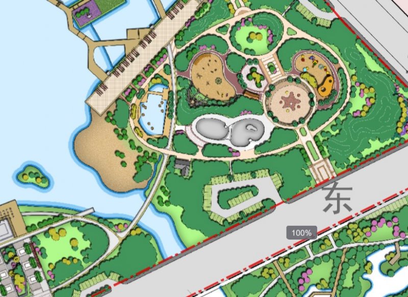

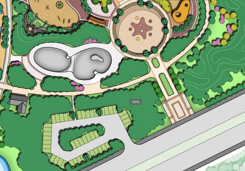

in Cad2006, I assembled 6 pieces of colored plans (jpg), each above 10 MB. I did this because scaling and aligning files this size in Photoshop is a real pain and inaccurate.. anyway, when I printed them to pdf (I did select for maximum quality in printing dialog), the lines in the image was a bit fuzzy when viewed for original size. the original ones are sharp as hell on the same scale. and I made sure I DID NOT print larger than the original. luckily the quality loss was not obvious for final use on the A1 poster. still, I wonder if anything can be done to output losslessly.
in CAD;
plotting;
plotted and viewed 100%;
source image at appr. same scale
source image viewed 100%;

What plotters are you using? What are you using to create the PDF?

good question, I've updated the post

since plotter question was brought up, I figure I should try some other printer or format.
so I created a tiff printer and manually set DPI to 300, paper size calculated for A1.
the result looks good this time. (except the file, is 265MB :lol: )
I guess pdf is not the best afterall. thanks everyone!
