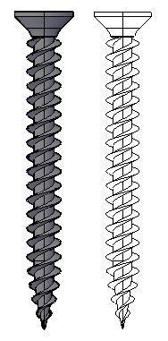

I don't have AutoCAD2010, but in 2011, I used the ACISIN command and the screw was imported as a solid. I didn't try Solprof, but FLATSHOT worked fine.
Are you sure it isn't a block, should have come into AutoCAD as a 3d Solid, what does properties list it as?
SOLPROF works fine on SAT files.
