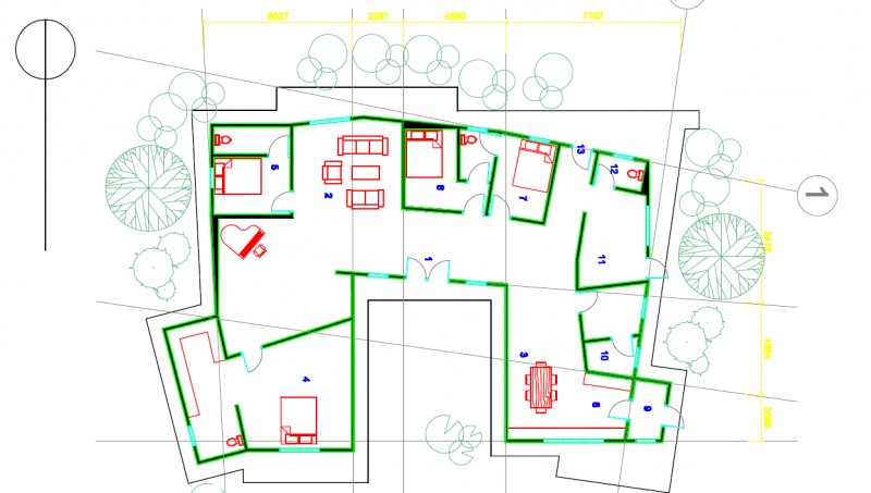

zahid94 Posted January 19, 2014 Posted January 19, 2014 Hello, Im new here,but I know a little bit about autocad.I have a question about my new project. My teacher said i need to create this kind of plan. http://www.scribd.com/doc/200714493/mmansndla-eg Can anyone recommend me any related tutorials videos? and another question, what is the numbers in yellow colour? Is it the measurement? Thanks in advance Quote

zahid94 Posted January 20, 2014 Author Posted January 20, 2014 here is the file from attachment, sorry for double posting. Model.pdf Quote
gazza_au Posted January 20, 2014 Posted January 20, 2014 The yellow text would be dimensions in mm, there are plenty of good tutorials on youtube but i have not got time to look for you. Try and copy the dwg attached it's close to scale, good luck. Gazza Model.dwg Quote

ReMark Posted January 20, 2014 Posted January 20, 2014 There are a number of tutorials here at CADTutor. Have you gone through them all yet? You can also find tutorials at a place called http://we-r-here.com/cad/. You will not find any tutorials specific to the project posted. There appears to be quite a few dimensions missing from your PDF. What information has your instructor given you or what have you learned in class thus far that will help you to come up with a similar layout? Quote
ReMark Posted January 20, 2014 Posted January 20, 2014 (edited) You wrote: "My teacher said i need to create this kind of plan." Does this mean redrawing the plan you have posted is NOT the actual assignment? Will you be doing this drawing in metric units? How detailed does the floor plan have to be? Will you have to include furniture and landscaping in the plan? Will it have to be fully dimensioned as well? Are you familiar with creating an architectural floor plan? Did you happen to notice there are no sinks, bathtubs, showers or appliances in the handout of the house your instructor gave you? That's odd. Edited January 20, 2014 by ReMark Quote
ReMark Posted January 20, 2014 Posted January 20, 2014 The yellow text would be dimensions in mm, there are plenty of good tutorials on youtube but i have not got time to look for you.Try and copy the dwg attached it's close to scale, good luck. Gazza Interesting drawing. There are some anomalies (ex. - take a look at the doorframe and door in room #10). Did you use a PDF to DWG conversion program to obtain the result? Just curious. Quote
zahid94 Posted January 21, 2014 Author Posted January 21, 2014 You wrote: "My teacher said i need to create this kind of plan." Does this mean redrawing the plan you have posted is NOT the actual assignment? Will you be doing this drawing in metric units? How detailed does the floor plan have to be? Will you have to include furniture and landscaping in the plan? Will it have to be fully dimensioned as well? Are you familiar with creating an architectural floor plan? Did you happen to notice there are no sinks, bathtubs, showers or appliances in the handout of the house your instructor gave you? That's odd. thanks for replying remark, yea, its like redrawing it in the CAD, before that, forgive i did not mention about detail stuffs before posting, here is the required task. Task You are required to produce an AutoCAD drawing of the given plan layout. The final outcome should consist of TWO (2) drawings: 1. Site Plan (Ground floor plan with its landscape compound) 2. Ground Floor Plan with its detailed interior layout. You are required to complete the proposed layout section with 3 bedrooms, each with its own bathroom. Task: The drawings should be: 1. Plotted in separate sheet. (A3 Landscape Layout) 2. Neatly plotted with scale. (Plan 1:100, Site Plan 1:200) 3. Completed with basic drawing elements ( Dimension, Grid Line, Text, etc) Im quite new to autocad, just need some related tutorials then I can do it by myself.Yes , I need to include the furniture and landscape as well. Yea, i happen to notice there is no bathtubs and sink, i think i might ask the instructor about this. Thanks again Quote

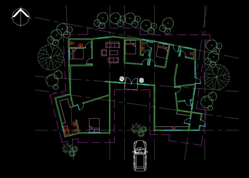

ReMark Posted January 22, 2014 Posted January 22, 2014 (edited) Given that you are new to AutoCAD Zahid I think it would take you about eight hours to do the floor plan. I did this last night while waiting for the snowplows to bury my front sidewalk under several inches of snow. It was bitter cold last night. Brrrrrrrrrrr. Edited January 22, 2014 by ReMark Quote
zahid94 Posted January 22, 2014 Author Posted January 22, 2014 wow, almost like the same with the layout given Yea im quite new, the outline didnt say anything about the thickness, yea i think this is my first time for the floor plan. I dont think the student is allowed to alter the design, all I need is to reconstruct it. The dimension is quite high tho 7k something..?? sorry im a total noob in scaling . Quote
ReMark Posted January 22, 2014 Posted January 22, 2014 (edited) Yes, "almost" like your image/PDF but not exactly. I made a few subtle changes. Zahid: When is the project due? Have you started on it yet? Given the pace we are going at this may take us a couple of months to complete. Do you have that much time? Since you have not been given a fully dimensioned drawing to work off of then you only have two options for recreating the floor plan as I see it. If we were to draw a box around the perimeter of the drawing, very nearly at the end of our guidelines (excluding the north arrow and the SUV) it would be approximately 31428x24025. Edited January 22, 2014 by ReMark Quote
