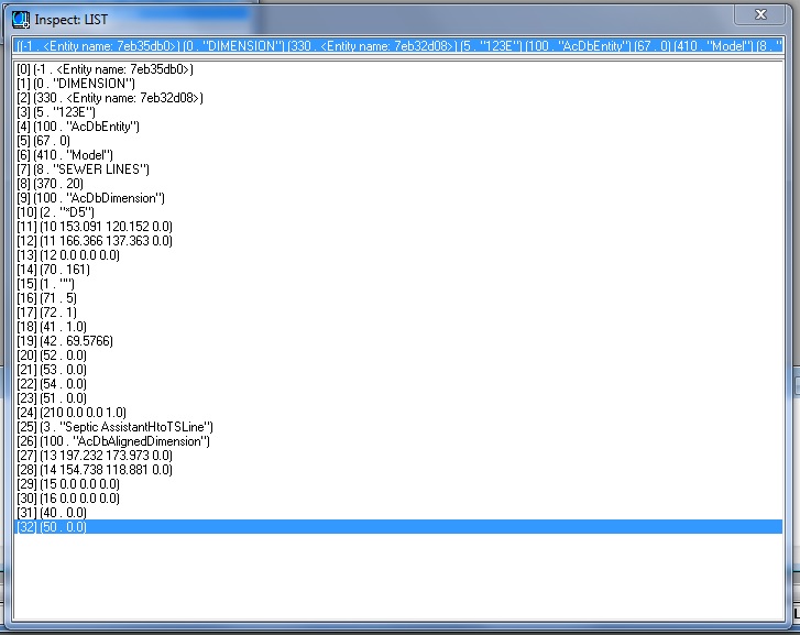

If you use VLIDE to inspect a Dimension Entity, the following is what typically appears..
... Am I not getting what your trying to tell me, or do you not understand what I'm asking...
Why would I do that? I am not talking of "AcDbDimensions". I am talking about "AcDbDimStyleTableRecord". Maybe I am missing something.

Jef!,
I quickly see at least three of the DXF codes you listed, on the list of DIMSTYLE DXF Codes on the last link I posted. (there may be more) Not sure what to say about the unlisted ones..
Apparently there are also undocumented 341, 342, 343 & 344 codes (no idea just what they control).
Sometimes you need to do a little investigation, try changing a couple of the group codes in question VIA, setvar as they are listed and not read only variables, then do a regen. Finally in VLIDE in the view menu item, browse drawing database, browse tables select the dimension styles and see just what changed.
