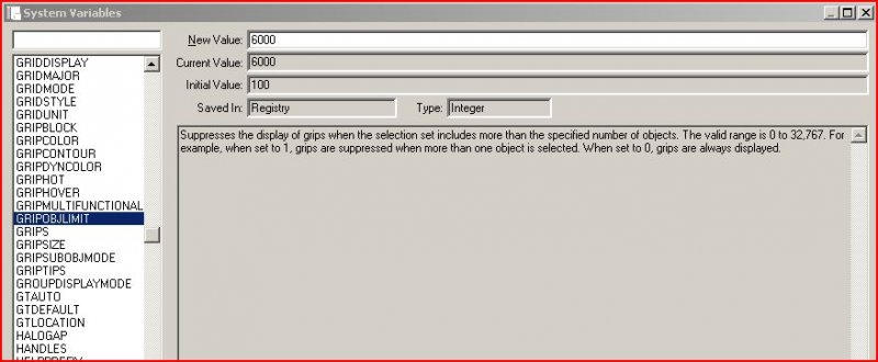

Dadgad Posted January 21, 2014 Posted January 21, 2014 You might want to check your GRIPOBJLIMIT variable setting, as described in the screenshot. Quote
