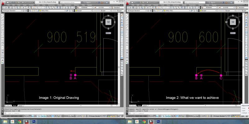

I dont think that i explained myself very well. See attached image.
Image 1: Is the orginal drawing
Image 2: is what i want to achieve.
In this example there is an opening in a blockwork wall. Image 1 can see the opening is set 519mm from the end of the wall. This doesnt make sense and should be 600mm. In image 1 you can use stretch move the opening from point 'A' to 'B' by adding 81mm. However this require calculation.
In the firm i use to work for they used stretch to shift the door opening like in image 2. First you would use the stretch command and select the opening. Select point 'a' which then you would hit there custom shortcut then click point 'c' and type the dimension (in this case '600') this would move the opening to point 'c'.
I hope that's clearer.

It had to be a custom lisp routine assigned to the Stretch command.
