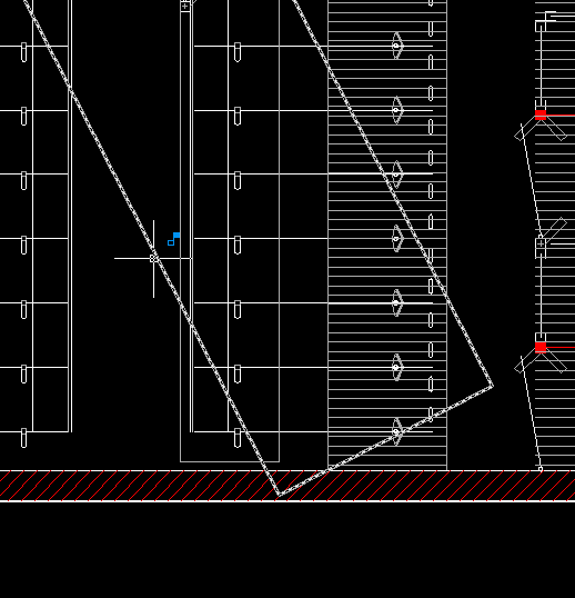

What have i activated in AutoCAD Mechanical?
My Autocad is acting weird....
I have a´ blue pointer when I point on some lines. Do anyone know what I have activated in AutoCAD Michanical?
Thank you in advance :)
Sandra
Sandra, that symbol means that the item have some constrains added to it (from Parametric menu).
Thank you very much :)
We are not using parametric menu.... Do you know how to switch that off?
On the Parametric Robbon there is a button for Delete Constraints.
There is also a button at the bottom of the screen (on the same bar as OSNAP and POLAR) that is called Infer Constraints. If that is on then everything you draw gets automatic constraints - so make sure it is off.
Thank you so much :) That helped.
