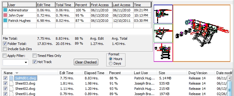

Patrick Hughes Posted January 26, 2014 Posted January 26, 2014 (edited) http://www.cadtempo.com/ This might be what you're after. Thanks for the mention Tannar. PaulS00 Here's a partial screen cap of some of the history data that CadTempo can provide. The 30 day trial may be enough to dissuade your people from not complying with your standard. Edited January 28, 2014 by Patrick Hughes Quote
