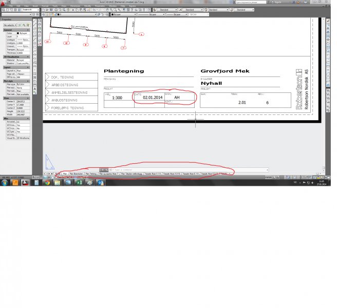

hvitost Posted January 27, 2014 Posted January 27, 2014 Hi guys I am wondering if there is any way that the date, and the drawers name could be dynamic(?). So that if i change the date on none layout, it changes on them all. AND, maybe it is possible to make the drawing nr and revise-nr automatic for each layout? To explain a bit how I use layouts and drawing nr’s: I usually draw everything in one drawing (cross-sections, façade(?) and floorplans), and create a whole bunch of layouts where I use viewports and find the section etc. that is meant for the specific layout. This means that when I have to revise on thing in the drawing, I have to change the date for every layout, and the revise-nr. I don’t want to do this I want to type in the revise-nr one time, and then I want it to be automatic in the rest of the layouts. The same with the date. Putting a screenshot up here so you maybe could understand what I mean. Everything on the screenshot is in Norwegian, but I guess you get the point So, if you guys understand this, is it possible? Quote
Mike_Taylor Posted January 27, 2014 Posted January 27, 2014 You can do what RobDraw mentioned or put some of the text inside of the title block (text that is consistent through all sheets). Any text being modified per sheet can be created an attribute. Quote
steven-g Posted January 27, 2014 Posted January 27, 2014 Or place information attributes that relates to the project/dwg in model space and use a viewport in each layout that is overlapping the title block, Or the whole title block in model space viewed through a viewport in paperspace layouts, with just a few attributes in paper space that contain layout info. Quote
rkent Posted January 27, 2014 Posted January 27, 2014 Create custom fields, update from the drawing properties. Or use the Sheet Set Manager to manage your custom fields. Quote
SuperCAD Posted January 27, 2014 Posted January 27, 2014 Use custom fields for information that will remain the same on every sheet and use DWGPROPS to edit them. Use attributes for information that will be sheet specific. Quote
Dana W Posted January 27, 2014 Posted January 27, 2014 I vote for the xref'd title block & border. Whatever is changed will only have to be changed in one place except for the page numbers. Anything unique to a page will have to be left blank in the titleblock dwg file, to be filled in on the paperspace layout. Everything else will reload from the xref every time you open a dwg file. This method will work best when under the project folder, there is a sub-folder for each drawing title, with both the main dwg file and the xref dwg file in it. Then, the same xref'ed title block can be inserted on each layout tab for one drawing. Any other drawing titles will have their own copy of the titleblock drawing in their sub-folder. I use this method and I have found it critical to add the drawing title to the borderline and titleblock dwg name. Then, if it gets moved it won't overwrite any of the other titleblock drawings. Quote
