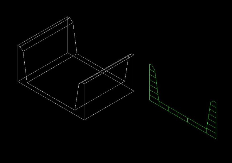

ReMark Posted January 29, 2014 Posted January 29, 2014 Yes, if they are watertight. Use the SURFSCULPT command. I tried it on your model but it failed. Command: SURFSCULPT Mesh conversion set to: Smooth and optimized. Select surfaces or solids to sculpt into a solid: Specify opposite corner: 15 found Select surfaces or solids to sculpt into a solid: Modeling Operation Error: Operation did not add or remove material. Solid creation failed, no watertight volume detected. You could also use the THICKEN command which will give you a solid. Quote
ReMark Posted January 29, 2014 Posted January 29, 2014 Using the THICKEN command to create a solid. Your surface is on the right in green. You could use the same procedure on both your cylinders. Quote
