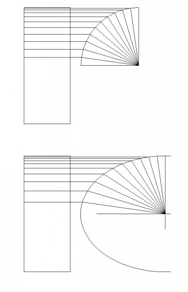

clmarchand Posted January 29, 2014 Posted January 29, 2014 How do you make curved elements appear curved in a 2d drawing? Quote

rkent Posted January 30, 2014 Posted January 30, 2014 I've never used shade, how do you do that? It isn't a command, it is old school drawing. See attached. Quote

clmarchand Posted January 30, 2014 Author Posted January 30, 2014 so this image just looks like the edges are hatched right? I tried that and it's not as pretty as that Quote
rkent Posted January 30, 2014 Posted January 30, 2014 You will want to draw individual lines, closer to the edge, further apart toward the center. See the left most image, the others are sections with hatch. Quote

tzframpton Posted January 30, 2014 Posted January 30, 2014 Here's an example of rkent's method.... unless he has a better/different method. linework_shading.dwg Quote
rkent Posted January 30, 2014 Posted January 30, 2014 (edited) Here's an example of rkent's method.... unless he has a better/different method. That is the one, thanks for posting the drawing. Using an ellipse will give a little bit better effect than a circle. The image is rotated 90 but you get the idea. Edited January 30, 2014 by rkent Quote
