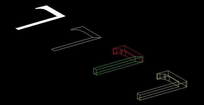

ReMark Posted January 30, 2014 Posted January 30, 2014 An example of text that has been extruded. Starting on the far left we have the number "7" created using the Times New Roman font. The font is filled. When TXTEXP is used to explode the text the end result is two closed polyline profiles. The fill is lost. Depending on the font, when it exploded it may end up as being larger than the original size. It would have to be rescaled. The red and green "7" has been extruded. Both sections are now solids. In this metric drawing the height was set at a little over 12mm. If we use the Union command we can combine both the red and green sections to end up with one complete solid shown here in yellow on the far right. So the commands used were TXTEXP, Scale, Extrude and Union. OK, it's almost 7 p.m. here on the east coast of the U.S. I'm going to call it quits for the day and go read a good book. I will check this thread some time early Friday morning. See you then. Quote

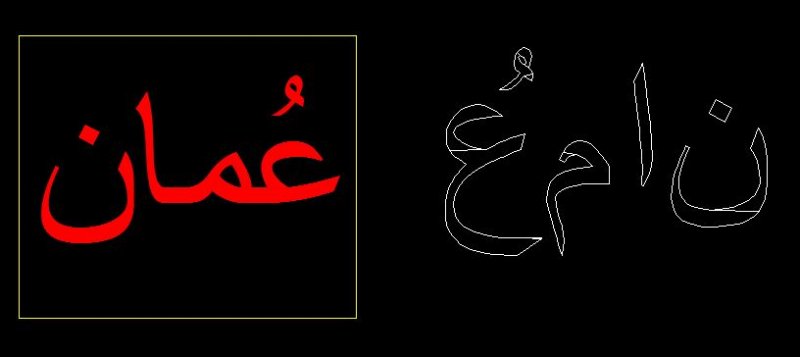

wanted90 Posted January 31, 2014 Author Posted January 31, 2014 Thanks mark , Can please make word (عمان) as polyline so I face there problem to create polyline please help me in that then later I will do extrude and engrave for it with required size Quote
ReMark Posted January 31, 2014 Posted January 31, 2014 That word looks familiar. I may have done it already as part of another thread. From what I remember the method I described in my previous post (re: number 7) did not work. The problem was that when the word was exploded the Arabic font used resulted in profiles that were not the same as the word. As a workaround I traced the outline of the word using polylines then extruded them. I will see if I can find the thread. I will also look to see if I retained my original work although chances are I deleted everything since it was no longer of any use to me. I was thinking about your reference to CNC last night. Is it your plan to cut the license plate numbers and letters into a solid block of material using a CNC machine at your school/college? Quote

ReMark Posted February 1, 2014 Posted February 1, 2014 This is the problem you will encounter if you use TXTEXP on the Arabic text the OP is requesting help with. On the left, in red, is the MText object. On the right, in white, is the result of TXTEXP. BTW...the exploded text has to be scaled down. Quote
