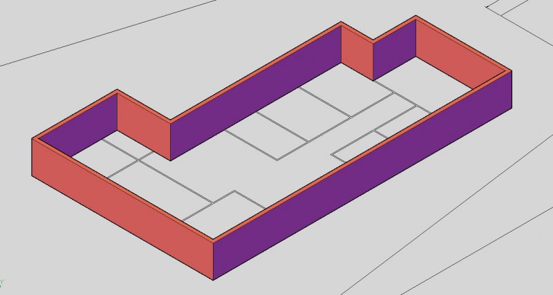

casho88 Posted January 31, 2014 Posted January 31, 2014 Hello, I have drawn a plan of a house. I used the presspull command to lift the exterior walls 3m. The problem I am facing is when I attempt to lift the internal walls, there is a grid pattern that forms, whereas no pattern has appeared on the external. Can someone please tell me why this is? I have looked through properties but I can't seem to change the pattern. My exposure to Cad is little so advice would be appreciated. I am using AutoCAD 2014. Thank you 300114.dwg Quote

ReMark Posted January 31, 2014 Posted January 31, 2014 (edited) You don't have to clean up the interior wall intersections. All you have to do when using PressPull is pick inside the two polylines that make up your exterior wall. I think you may have done something different. The result you see above required no changes to your original 2D linework. I think you may want to check the height you are using for your walls. After rereading your initial post it dawned on me that you raised the walls "3 meters". Did you know that you were using an imperial template and not a metric template? The default units setting is Decimal inches. You should have started your drawing using the acadiso.dwt (metric template file) instead of acad.dwt (imperial template file). Edited January 31, 2014 by ReMark Quote

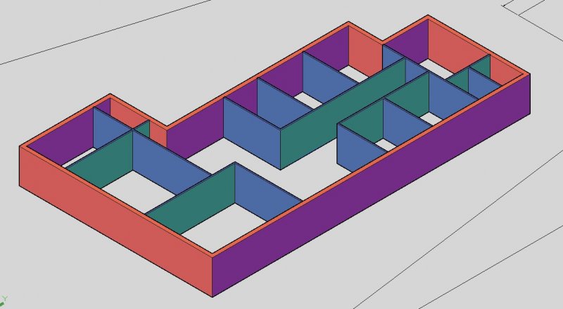

ReMark Posted January 31, 2014 Posted January 31, 2014 Interior walls added. The technique I used was a little different. I decided to close off all the open ends with lines, used the PEDIT command to create and join the lines as polylines then used the Extrude command to give them the same height as your exterior walls. Now it is just a matter of punching holes in our walls for doors and windows. The PressPull command should do nicely. Quote

casho88 Posted February 3, 2014 Author Posted February 3, 2014 Hi ReMark, yes I think the problem was on my plan, I had drawn lines over lines which meant I could not pedit the individual lines into a polyline. I cleaned my lines up and the pattern has disappeared. Thank you for your help! Quote
