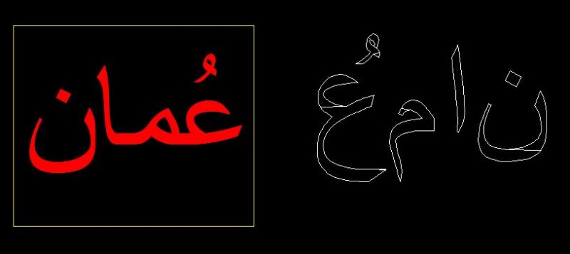

wanted90 Posted February 1, 2014 Posted February 1, 2014 Hi please can anyone help me to make this word as polyline becuse I want to do extrude to that word please help me http://www.up-00.com/?FMsH Quote
ReMark Posted February 1, 2014 Posted February 1, 2014 I'm pretty sure I already did this for you back in November of 2013. You had a thread about it which I linked to in the thread you started a couple of days ago! For any other member reading this see the OP's thread (of 30th Jan) entitled "Help me create extrude and engrave". When you find it go to post #9 and click on the link to the OP's thread of November 2013 where we discussed, in detail, the particular Arabic word he is inquiring about getting help with. There really shouldn't be a need for three separate threads about what is basically the same project. Quote
ReMark Posted February 1, 2014 Posted February 1, 2014 What happens when one uses TXTEXP on the Arabic font used to create the MText object included the the zip file the OP has linked to. Quote
ReMark Posted February 1, 2014 Posted February 1, 2014 Attached is a drawing with the text converted to a solid. You did 99% of the work back in November. Maybe you forgot? oman_remark.dwg Quote
wanted90 Posted February 1, 2014 Author Posted February 1, 2014 Hi mark , Yes I did same topic but here the size is not same Now here in this topic I want any one to help me to make that word as poly line so that will help me to make extrude to the word .. If no one help me , please give me another method to make extrude coz I am not familer to use Arc and line It will be no ok it's look Quote

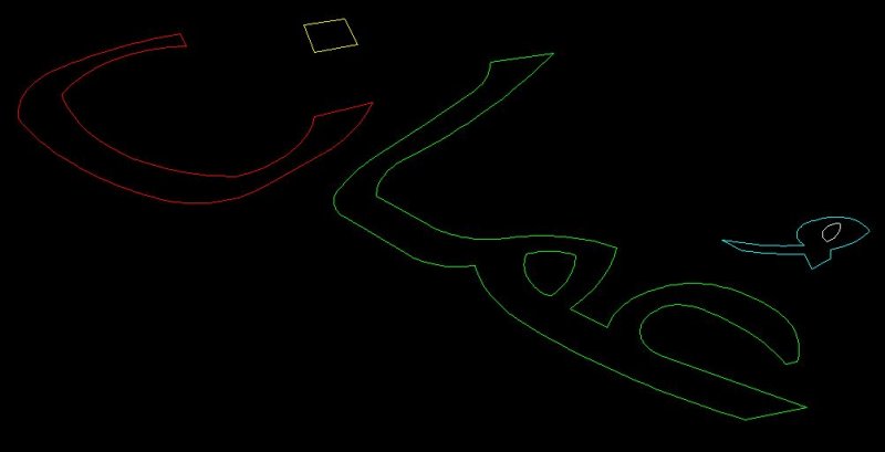

ReMark Posted February 2, 2014 Posted February 2, 2014 (edited) Explode the solid. What's left are surfaces. Erase them carefully and you will end up with a total of 5 regions. Edited February 2, 2014 by ReMark Quote

ReMark Posted February 2, 2014 Posted February 2, 2014 Each color represents a different region. This is what you would end up with if you follow my previous instructions regarding the drawing I gave you yesterday. Quote
