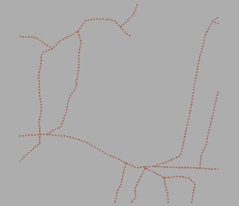

For a school assignment, we were given a .dwg file that had errors and no object class data. Our job is to clean the topology by joining 'like' features, use the drawing clean-up, and then create object data. The topology and drawing clean-up is ONLY supposed to be done on 4 layers: Contours, Road_Centre_Line, Access_Road, Road_Construction.
At this stage, no object data has been created, so my concern is not regarding that. I'm trying to join the lines in the Road_Construction layer, but they will not join. I read the help files for AutoCAD but I don't quite understand why they won't join. Hopefully someone can look at the file and let me know why they won't join and how to get them to join? Alternatively, since this assignment is to get us familiar with mapping standards (I know there are probably thousands, but...) is it standard practice to have a layer such as that one to be all one single connected object? I had a thought that maybe they aren't supposed to be connected because they are separate roads.

I attempted to do these two things before - I never really tried changing the tolerance, but that didn't seem to solve my problem. The lines are all touching each other, but I think the issue is that they intersect perpendicularly...from what I understood from the help files, a simple joint does not allow the user to join perpendicular intersecting/crossing lines.
Having looked at the drawing, all the lines on layer Road_Construction are already polylines with a thickness and width.
You do know that polylines cannot branch? I cannot see where there is joining left to do. :?

I think the OP is wanting the "branches" too. As Autocad plines have only one start point and one end point that's not possible.
Thanks guys, that does in fact help! I haven't had much experience at all using AutoCAD, except for a few tutorials from a textbook. As I said before, I thought that those polylines for Road_Construction were fine as is because they were separated into different roads, but I was just nervous to submit it that way because I wasn't sure if there was actually a way to join them.
