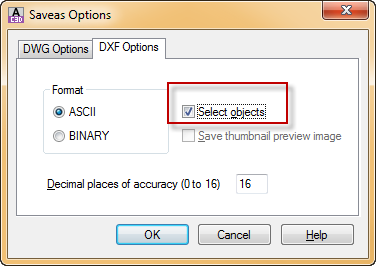

If it's a one or two time thing and you just want the clean geometry to get moving on, then SaveAs R12 DXF and "select the objects" (don't just SaveAs the entire drawing).

The SaveAs>R12DXF>Select Objects trick works almost every time for me when I'm just in a hurry and I don't have time to stop and fix the whole problem (or don't care because I just need the objects and don't care about the source DWG)

rkmcswain's advice worked
The electrical designer here was able to get what he needed
