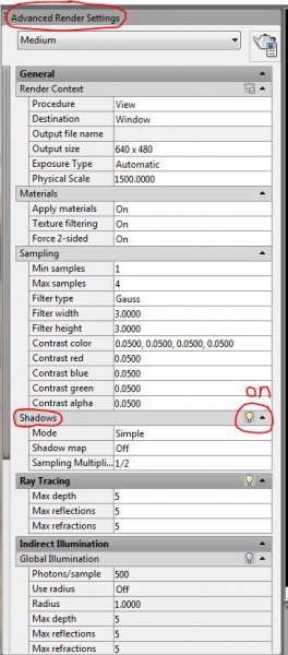

sigaukedenn Posted February 4, 2014 Posted February 4, 2014 Hello guys, i have a problem with just one drawing that i have done that is totally refusing to give me shadows, is there a setting that i might have altered to prevent this and what needs to be done so as to ensure the shadow comes through. Regards Sigauke Denn Quote
ReMark Posted February 4, 2014 Posted February 4, 2014 (edited) Under Advanced Render Settings make sure the lightbulb seen circled below is "on". Use the Hotkey rpr to invoke or type RPref at the command line. Edited February 4, 2014 by ReMark Quote
sigaukedenn Posted February 5, 2014 Author Posted February 5, 2014 Thanks for the advice but still no shadows, is there another setting that i can try... Quote
