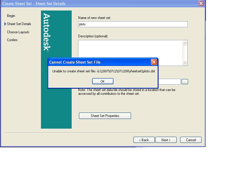

Can some one help with sheet set manager i've tried to set one up before but i encounter a problem see attached -any ideas
I'd assume that that location doesn't exist ... Pick a place where you want to save the sheetset-file and give it an appropriate name
So far I've found that others with this issue try a repair install or a full uninstall-reinstall to see if it fixes it.
Another page said that if you have a Linux based server this becomes an issue in which case I guess you'd have to save the sheet set file locally.
The Autodesk knowledge base doesn't seem to have one lick of information on this issue.
Doesn't look like you have access to that particular drive [G:].
I dont have acess to drive G:
Thanks - thats it i'm sure. now to set -up some sheet sets :twisted:
