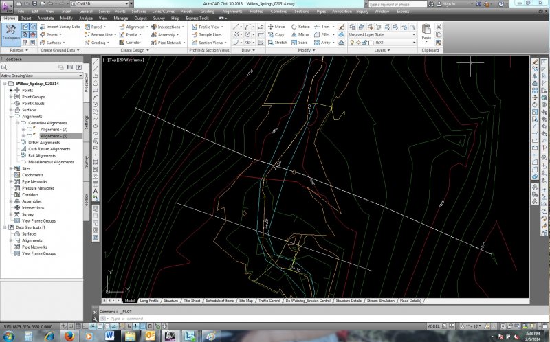

Below is a screen shot of the existing ground contours. The cyan lines are my channel. I've got a profile line along the alignment at a higher elevation. As you can see the profile lines and contours in the grading are all over the place.

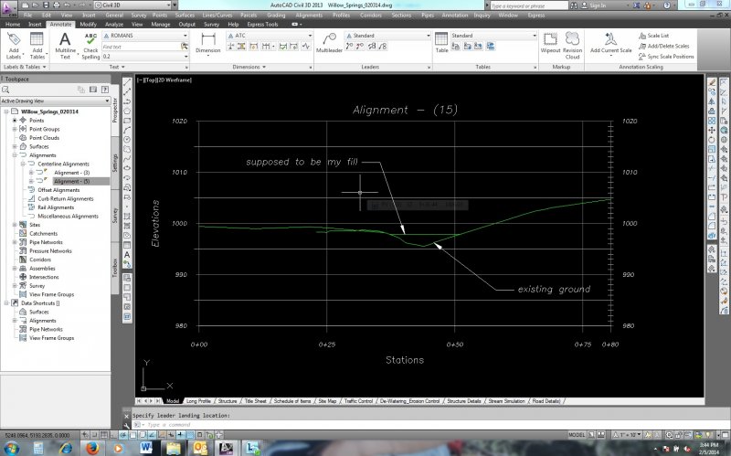

This is a quick profile view. As you can see the fill line is not flat like I had hoped and it doesn't end at the existing ground.

After seeing this, any suggestions? As far as a corridor goes, I haven't used them before. I'm guessing for a basic flat line like I'm looking for it wouldn't be too difficult would it? Would I be able to get fill quantities using the corridor feature? Thanks.

If you are trying to fill the channel to a specific elevation and add a cut/fill slope at each side I have to agree with bill below, a corridor is the most appropriate solution.
