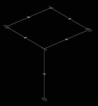

Hello Autolisp world
I m an engineer and dealing with hydraulics alot. I have a hydraulic calculation software that accepts numbers as nodes incrementally in an common text editor. Every node however is unique in space connecting 2 pipes (e.g. through an elbow) or 3 pipes (e.g tee). The numbers are arbitrary. For instance
1 2 4 12U
2 3 4 5N
3 4 4 5E
4 5 4 5S
5 2 4 5W
The above creates a square of 5 ft side made of of 4" pipes feeded by a riser of 4" and 12 ft high. The first two numbers for every line represent the start and end node. The next the nominal diameter of pipe and the last the length along with the orientation of it.
I have made so far an autolisp routine that writes in a txt file lines like the above per every line sketched in Autocad representing accurately the pipe network using a while loop and a counter. I retrieve the coordinates of start and end points (x,y,z) using handles 10 & 11 and I concatenate the numbers so that I can make them unique in space. When one pipe has coordinates in space starting point 50,35,12 & endpoint 70,35,12 the number for the start & end point formed is 503512 & 703512 respectively. So my program writes in a new line
503512 703512 4 20E
This pipe has starting node 503512, end node 703512, 4" size and runs 20 ft to the east (taking as given that positive y is north). Repeatedly this is done for all lines in the pipe network.
Here begins my problem. My hydraulic software does not accept node numbers greater than 99999. So this means that I need to translate all of my points in the format xxyyzz to something less than 99999. No matter what it is but it has to be between 1 to 99999. It also has to be unique because on that node other pipes may be connected.
I haven't been able to to so. I need a function I guess that gives me these unique converted values or something like a renumbering routine but I couldn't figure it out. Maybe my whole approach is not correct. Any help will be deeply appreciated.

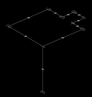

I am not sure I m following you fully. Needless to say I m not an Autolisp expert. My intent is not to have list of all nodes. My intent is as explained in my first post. An ascii character file with every line having start node, end node, pipe size, length & orientation. I ve managed to put all of it in a txt file but the order cannot be arbitrary. Every start node must have been given earlier (above in the list) otherwise the software gives error. See below this imaginary pipe system
Assuming that all pipe segments have a common diameter of 4" and a length of 5ft, and they are created in the order 0-1, 1-3, 3-4, 4-2, 2-1, the correct way to write this is
0 1 4 5U
1 3 4 5E
3 4 4 5N
4 2 4 5W
2 1 4 5S
As seen above the numbers need not to be an incremental pattern. Except the first line, all starting nodes are defined as ending nodes somewhere above, no matter where. It can be 1 line above or 1000 lines above.
All of this I have already made using basically a ssget "X" '((0 . "LINE")) selection and a while loop for all lines. Therefore I can retrieve the pipe size, length and orientation plus the nodes. However if I delete the segment 3 to 4 and make it like the following due to an obstruction in the building:
my routine will be executed based on the creation order of all lines. That means that the five new segments between 3 & 4 will be respected as the last five. Therefore the list I ll get will be:
0 1 4 5U
1 3 4 5E
6 2 4 5W
2 1 4 5S
3 4 4 1.5N
4 7 4 1.5E
7 8 4 1.5N
8 5 4 1.5W
5 6 4 2N
The following gives an error simply because node 6 is not given above the third line (6 2). And this is what I am trying to solve.
I m sorry I m repeating myself but these are deep waters for me in Autolisp.
