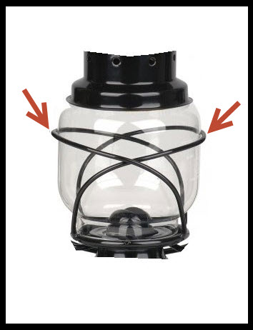

Could someone please give me some pointers on the best way to make the 2 metal clips in the picture below? I've tried everything I can think of. I'm assuming it has to be a swept circular profile along a spline, and its getting the spline in position thats the problem. (The rest of the model is already made).
I've tried 3d skeching with splines (fiddly and imprecise), Spline on surface (also messy, especially towards the ends), and trying to project the shape (won't even go there!).
Am I missing something obvious?
Thank you :)

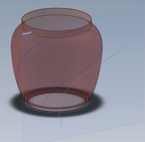

Ok, so I now have a curve, on the shade, that looks like something I can use.
[solved
Firstly, I want to put the curve into a new part, but SW wont let me copy it - 'object cannot be copied to clipboard' - is there another way? (I tried making a new part to contain the curve, but if i do that I get an error trying to project the curve ' Please select from the solid body of the component you are editing') ]
Secondly I need to increase the size of the 3d sketch, so that when I sweep a 1.5mm radius circle along the path it doesn' 'sink' into the glass. As its a 3d sketch offset entities wont work - would a scale operation be the way to go?
Thanks again.

Are you familiar with using the Surfacing tools?
Create an offset surface from the solid and project the curve onto the surface.
Attach your *.sldprt here if you can't figure it out.

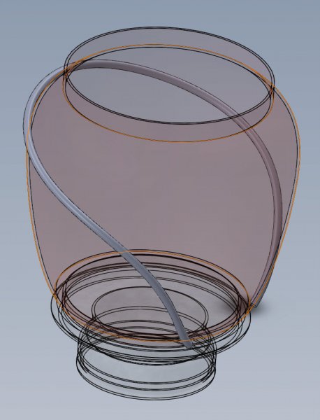

Took a while, but finally got it figured out - Thank you for the pointers Dr. :)
