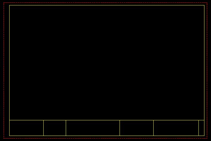

12barbeque Posted February 9, 2014 Author Posted February 9, 2014 not sure, I'm assuming in paper space. This is the Oleson village project. I'm having difficulties drawing the title block, It asks to activate the trim layer which I had to create at this stage since there was no mentioning of creating a trim layer earlier in the project. it asks to draw using the line command a 24x36 landscape border for trimming how do I do this? I'm in model space Quote
ReMark Posted February 9, 2014 Posted February 9, 2014 You should have mentioned the Penn-Foster Oleson Village project up front. I am familiar with the project. Give me a moment to check something and I'll be right back. I'm baaaaaack. As I thought. Your title block and border will be drawn in model space not in paper space. Apparently Penn-Foster has yet to instruct its students in the use of paper space and viewports and is still doing their projects "old school" meaning everything is placed in model space. Your will create a layer called TRIM. The linetype will be Dashed and the color will be red. You will draw a rectangle 36 units long by 24 units wide. This in effect is the extents of your paper. Your title block and border will be drawn with the limits defined by the dashed line. When you have done everything required then P-F wants you to scale the title block and border (including the dashed "Trim" line) until it is of a size that will fit comfortably around the extents of Oleson village. You'll know you have the right size when the "Trim" edge measures 1800x1200 units. Got all that? Sorry, but I have to go now. There are several Oleson Village threads here in the Student Project forum many of which contain images that might prove helpful to you. I will check this thread early Sunday morning to see if you had further questions. That is the best I can do for the moment. ReMark Quote

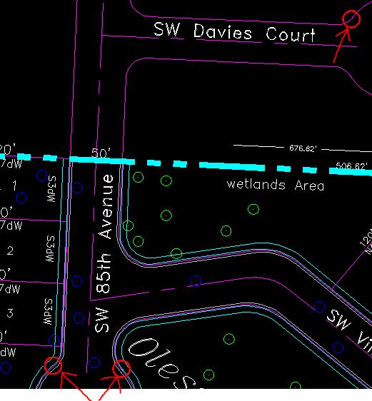

12barbeque Posted February 10, 2014 Author Posted February 10, 2014 Hello Remark, Ok I redid my drawing up to the 24x36 landscape border for trimming with border inside section. I did have a little better understanding of it this time around. I attached the new drawing. If I can get any feed back on this one and some pointers on the border it would be greatly appreciated. Oleson-Village1A.dwg Quote

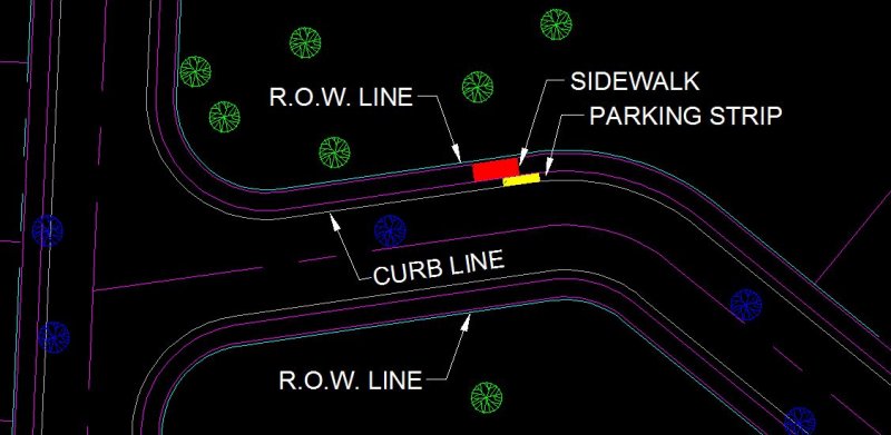

ReMark Posted February 10, 2014 Posted February 10, 2014 (edited) Lots 7 & 8 - You have two property lines drawn one on top of the other. You only need one line since it is a shared property line. These two lots also don't appear to be in the right location. Isn't there a 40 foot buffer between the east side of lot #8 and the streetline of SW Oleson Road? Your buffer is something closer to 51 feet. All your trees seem to be off by the same amount. Have you gotten to the point in the instructions where you are instructed to move the trees due to a surveying error? The curbline, planting area (parking strip?) and sidewalk all belong between the street R.O.W. lines. See post #66 and #67 of this thread http://www.cadtutor.net/forum/showthread.php?75731-Penn-Foster-Student-Suffering-with-Oleson-Village-Map!!!/page7 Note that the Penn-Foster instructions are wrong and should not be followed. If your instructor marks you down for doing it right have him come here and I'll explain it to him. You continue to have overlapping lines in the three areas circled in red below. In the future, do not attach a copy of your drawing (DWG) unless requested to do so. Attach an image (JPG or PNG) instead. Why? Because other Penn-Foster students, in the future, may decide to "borrow" your drawing thus saving themselves a lot of time and effort. Edited February 10, 2014 by ReMark Quote
ReMark Posted February 10, 2014 Posted February 10, 2014 Relationship of sidewalk, parking strip/curb to R.O.W. line. Quote

ReMark Posted February 10, 2014 Posted February 10, 2014 (edited) 12bar: What "pointers" on the border are you looking for? What my border looks like (sans text): Edited February 10, 2014 by ReMark Quote
