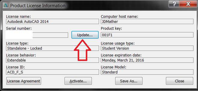

You did not need to uninstall the student version - all you needed to do was change the license.
Go to Help>About AutoCAD and click the Update to enter new commercial license SN.
Also, SP 1 does eliminates student version watermark.
The stamp will continue to show in existing drawings created or edited by the student version. As mentioned SP1 eliminates the watermark from showing up.
