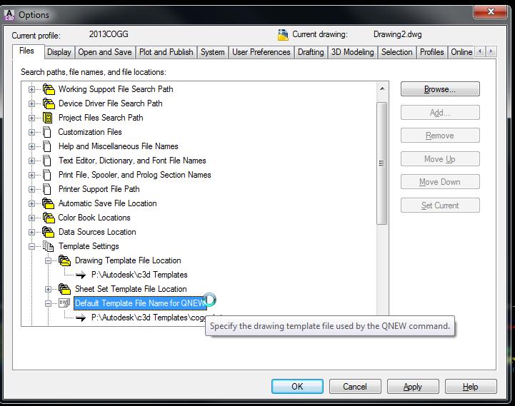

RobDraw Posted February 14, 2014 Posted February 14, 2014 Did you map the QNEW command to NEW? Do you not have a default template assigned in the properties? Either way, your QNEW doesn't work as it should. (See BIGAL's screen shot.) Quote
Dana W Posted February 14, 2014 Posted February 14, 2014 Did you map the QNEW command to NEW? Do you not have a default template assigned in the properties? Either way, your QNEW doesn't work as it should. (See BIGAL's screen shot.) It works the way I want it. I have Startup set to 0, the default dwt location is the enu\templates, and I have "none" for qnew because, like I said, I usually use the client's templates, stored in their respective folders, or I am continuing a drawing some other hack has already ruined for me, like today. This one has splines where there should be arc's and circles, a coonverted vector pdf. Of course nobody told me this when I quoted them a guess at hours. All I have to do is create viewports and paperspace dimension what is "already" drawn. Of course the paperspace dimensions are ignoring the splines, so I have to go trace all of them. Quote
BIGAL Posted February 15, 2014 Posted February 15, 2014 Dana why not just create a client qnew you can change the default location via lisp then run new or qnew. If you have your support path list pointing to home grown lisps then you can shorthand the load (Load "fredwnew") rather than a full directory path \myjobs\......etc (setq *files* (vla-get-files (vla-get-preferences (vlax-get-acad-object)))) (vla-put-QnewTemplateFile *files* "S:\\Autodesk\\c3d Templates\\fredw.dwt") (command "Qnew") Quote
