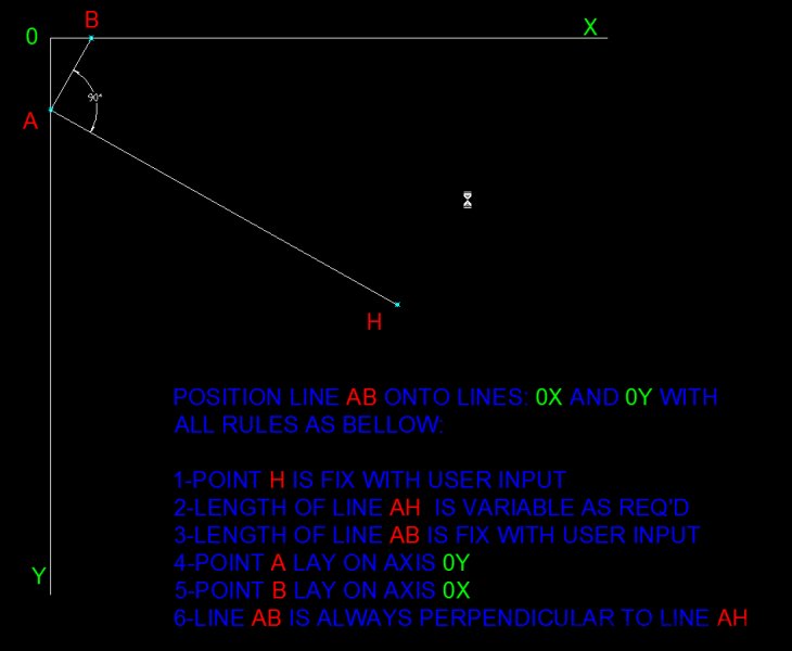

Line positioning within limit problem
As per picture: How I can do it with help of lisp?
Was trying to position it on AutoCAD but got no idea how without trial and error. Brain dead stage. Please help.
Axis 0X and 0Y is the limit.

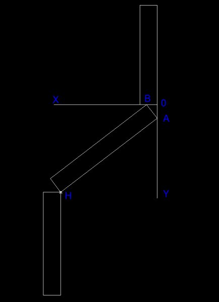

Hi Marek
I've tried to solve this problem some time ago and I couldn't find an exact mathematical solution using lisp, but just a (good) approximation.
I'll post it if you are interested, although it is a slightly different arrangement: the line starting from the known point H is perpendicular to the midpoint of the segment AB.
Anyway, you can use constraints to achieve the same result, or a dynamic block.

Stefan, anything solving this problem is very needed. Please post it.
I did try constraints. Just wonder about AutoCAD function "grread" that let object slide along line(?) and combining it with constraints maybe work-this is still magic for me.
My attempt (for x and y positive).

Awesome. Thank you.
We almost there.
What about actually selecting x and y, because it's always away from standard 0,0 coord and remove limit of location of pick first point?
Something like:
Pick point:
Pick x line: (horizontal)
Pick y line: (vertical)
Enter length of line:
After few cosmetics operation (move, rotate, align with 0,0) I achieve what I needed.
Big kiss for Valentine Day. Thank you.
